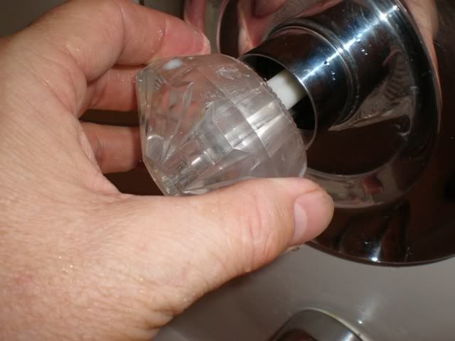

    Step 1: With the facuet turned off, remove the decorative button and the thin metal temperature indicator ring behind the botton. Just pry it out with your fingernail or gently with the tip of a screwdriver and set it in a safe place.
    Step 2: Use a phillips head screwdriver to remove the screw which holds the knob on. Pull the knob off and set both the knob and the screw in a safe place.

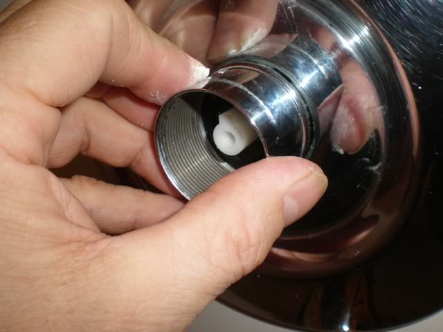

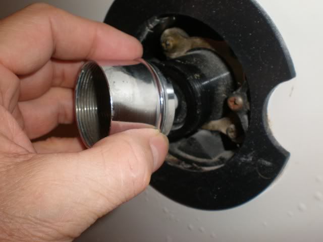

    Step 3: Unscrew the chrome ring which holds the main cover on. Just grab it with your hands and turn counter-clockwise. You can cover the ring with a rag so as not to scratch it and use a large pair of pliers if it happens to be stubborn but it should turn freely. Just pull it off and set it in a safe place with the rest of the parts.

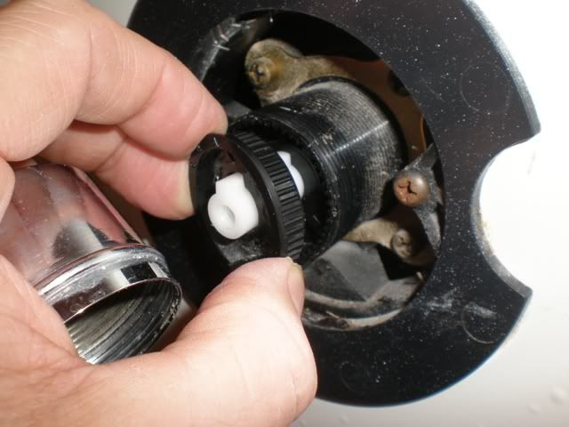

    Step 4: Here is where the fun begins. The cartridge which controls hot and cold water is now exposed. On the front of the cartridge is the plastic temperature limiter which is keyed to prevent the faucet from being turned too far toward hot. The temperature limiter can simply be removed by pulling on it with your fingers as shown in the picture below.
    The plastic temperature limiter looks like this...
    And the front of the cartridge with the limiter removed looks like this...

    Step 5: As stated above, the keyway in the temperature limiter prevents the hot water from being turned up too high. In the case of this particular faucet, the piece had somehow rotated one or two notches clockwise and simply had to be rotated slightly counter-clockwise and put back in.
    Rotate the temperature limiter slightly counter-clockwise and push it back in. The keyway will now allow the faucet to be turned futher toward hot and allow more hot water to mix with the cold water, raising the temperature of the shower.

    Step 6: While you have the cover off, clean up any mold or dirt which may have collected on the surface under the cover. The gastket on my cover had deteriorated after many years of use and had a bunch of gunk underneath it as well. Wash off the cover as needed and apply a bead of caulk on the cover as necessary.

                    Also, I don't think the gasket deteriorated. If that was the bottom portion of the cover shown in your picture, there should NOT be a water tight seal on the bottom. Reason is, if any water somehow gets behind that cover, it needs a way to escape. You would want to put a bead of silicone from 6:35, all the way around to 5:25. Leave that 10 min section open for drainage.
