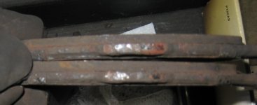

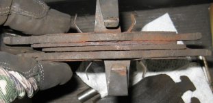

I would like to get your thoughts on the wear pattern on the cheap ass rotors below. It does not look as though the entire pad was making contact even though the weare was pretty even on the pads. Speaking of pads, the inboard pad that mates with this rotor was actually lifting up off of the backing plate.

Take more pics. I almost want to swear you have wrong OD pads matched to wrong rotor. The wear pattern should be further out on the outside of the rotor close to the edge. It looks as if there is a step on disc in middle of pad. Was there a notch or step worn in the pads?
The pic could be deceptive................
I agree, it almost looks like the wrong size pads where used on the rotor. What did the brake pad look like?

From what I see there no way you can say discs were new, the backside has so much corrosion it looks like the pad was not able to contact correctly. No way that corrosion happened in 27,000 miles. Somebody put the whammy on somebody looks like to me. I've not got corrosion anywhere like that on 150,000 mile parts.
Just my opinion of course, but I've never seen any that bad before...............
what you are seeing is a common thing in my service bay, especialy with cars that dont get driven much.
typicaly the car gets driven once a week, in the periods of sitting surface rust forms on the rotors, over time the corosion builds up under the pollished surface and starts to crumble, creating the rings on the outer edges. the upper pic of the pads also shows the friction matterial starting to sepparate from the steel backer.
in the upper midwest salt belt I've seen this happen in as little as 10000 miles with factory pads and rotors.
