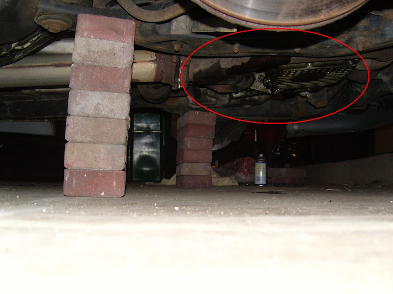

oh gosh i know. they were all cracked/busted after i took them out. i thought bricks/concrete had good load stress but not these ones!! and i have since bought a set of jackstands and lift which do work phenomenally better.
and how hard is it to replace the oil pan gasket? i mean i like the smell of burning oil and all, but not all the time.
the picture that svtdood posted and circled.. Well im now starting to notice oil on the same place (the white grid looking thing).. its not as bad as that pic but leaking oil is never good, so im just wondering if the damper/pulley thing is the cause of that?
and if so where can I look to get a visual inspection of the wobbly dampener pully? My serp belt is going bad as well, as stupid as this sounds, would that be a cause of any of this trouble? Also how much of a pain int he ass is this to change? dampener pully thingamabob?
