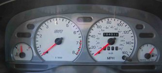

i did this yesterday and i dunno if anybodys done it yet but if not the new name will be sexifying the gauges...thanks northeast CEG!!

Looks good.Not sure if i would do it..But still looks good.Maybe a smaller shot catching that and some of the car dash etc..If you can get some more pics
What method did you use to seperate the lens from the backing?
Cant you just take a screw driver to it and pry it apart? Its probably been about 5 years since Ive taken it apart to swap out the SVT gauges and then the indiglos. From what I remember, it was fairly straight forward.
the lens does just pop off but the part that was painted is part of the lens ... they are glued together from the factory ...
yea itrs really simple. dremel and cut off bits, just go aroudn the edge and be real careful cuz the lens cracks easily but dont worry if it cracks a bit the dash covers it back up. FYI damn near impossible to separate perfectly. after you paint it with your method of choice... i used an airbrush. just glue back together and your good to go.

Here's what I did with mine:
Got 'em on Ebay from Germany. All I had to do was remove the cluster and I was able to insert them from the back & hot glue them in place at the back. When I'm done with the car I can removed them easily & peel away the glue to get the car back to stock.
Came out very clean. I like an understated look.
