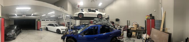

However all that said the car is still a work in progress. I've been held up with working on my DD (Audi TTS), my new born son (3mo), and still looking for a lot to build our house. Having said that I think we finally found one. The layout had to change a little bit, but I still am getting a shop be it not as big as the one shown in the photo previously. I've attached it up below.
Once this house is built I think you'll find my car projects will be completed within a year. So this 3.0L turbo project will finally come to an end.
