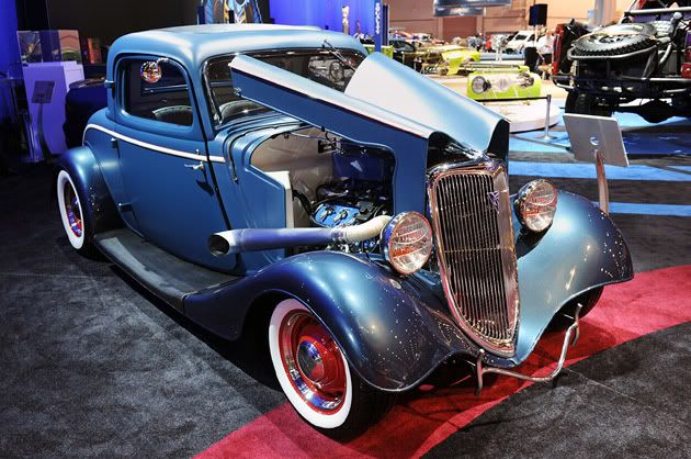

Hot damn that's sweet. I'd love to see the faces on people if they pop the hood on that car expecting a small block and see something super modern.

Yeah, not exactly the same league as what is being discussed here. That guy made all sorts of custom stuff, INCLUDING exhaust manifolds. I'm pretty sure he didn't go dig up some stock manifolds off a SHO.
