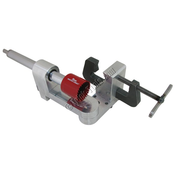

Figure its been a while and I should give an update. I wanted the last little bit of piping fab that I needed to do to be perfect since it was going to be highly visible. However to do that I really needed a notcher. Well I finally decided on the JMR Raceline TN300 unit. It seemed to be the best bang for the buck as far as features and quality. So with this tool I'll put the final touches on the inlet tube to the turbo with adding in a decent vacuum port and a port for my blowoff recir valve.
The other sweet deal with this notcher is I'll be able to make a top notch harness bar along with a more professional looking traction bar.
Yea got my notcher... although I went to use it and realized I didn't have a 2-1/2" hole saw doah. I did have a 2-1/4" and a 2-3/4" though haha go figure.
