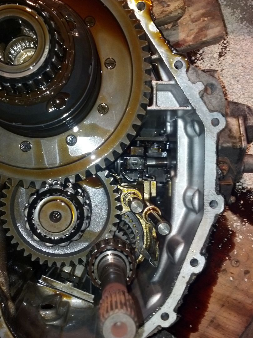

Nothing like pulling a transmission because the shift tower bolt sheared and it was stuck in gear...
Thought I would find an exploded clutch, looks fine. Luckily I've got another TOB, but the flywheel insert and PP are trashed too... Transmission going to get a rebuild by my buddy- upgraded forks too. Should be back with a vengeance...
Where can I get the shift forks and rebuild parts?
How many times have you had that trans out now? It is possible to fix that issue without pulling the trans. You can pull the tower and fish the bolt head out and swap in a new tower. I've had to fix that issue on a few cars now. Usually I go with the upgraded shift tower which isn't prone to this issue.
