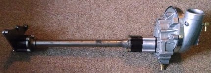

Coupler is done and she's ready to go back to beans. Freshly rebuilt s/c, jackshaft bearings rebuilt, and the missing block has been fab'd. Beans should be in business!
I see per the tracking info that the Vortech is out for delivery today... :)
Thanks gorman! Fortunately Vortech generally uses good design practices and 'off the shelf' parts and dimensions that make their stuff fairly easy to reverse engineer.
you're too modest.
in case you are interested for your next jackshaft re-build, SKF have now upgraded those jackshaft bearings. The E2 version are rated at 14000rpm in grease ... http://www.skf.com/group/products/b...gs/index.html?prodid=108002205&imperial=false .
Beans, don't run the vortech open air .... the oil atomization doesn't work efficiently unless the volute is pressurized ..... bearings run noisy. I'm running a short belt while i sort out a few minor issues ..G.
